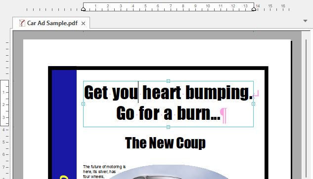

1.Open the PDF file that you want to edit.
2.In this example, an "r" is missing from the word "you".
3.Select the Text edit tool icon_tool_text-edit in the Quick access toolbar. The Text edit tool is the default tool when FlexiPDF starts, so it may already be selected.
Tip: The respective selected tool is indicated by the darker button.
Quick_access_toolbar
4.Click on the text that you want to edit in order to start editing. You'll see some pink marks – the pink dots represent spaces, while the ¶ symbol represents the end of a paragraph. These marks appear only during editing and are not visible in other PDF viewers.
quickstart - hyundai 1
5.Edit the text. In this example, an "r" is added to "you".

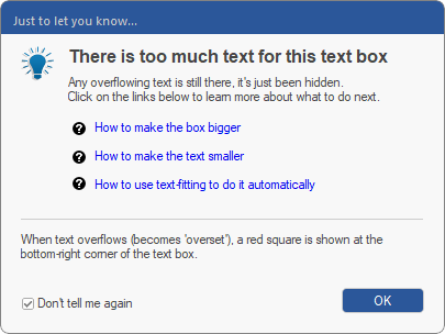

As soon as you do this, the program displays a warning about text overflow:
quickstart - overset warning
This is because the text box now contains too much text. This warning only appears once in order to alert you to the problem of text overflow in general.

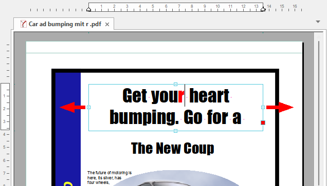

Otherwise, a text overflow is indicated by the red square red_overflow_sqare on the right margin of the text box.
6.To expand the text box in order to accommodate the additional text, drag the handles outwards to the right and left using the mouse. The text should then fit within the box.
Alternatively, you have the option of reducing the size of the text in the text box. For more information, see Text overflow.
quickstart - hyundai 3
The newly added "r" is displayed in red (if the option Show changed text in: red is enabled). For more information, see Highlighting changes. This highlighting is only visible in FlexiPDF and not in other PDF viewers.
