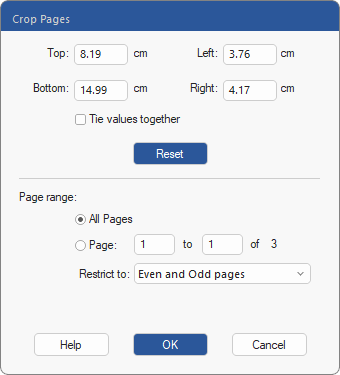

Important: When you are satisfied with the size and position of the drawn rectangle, press the Enter key on your keyboard. This will open the following dialog box, which is necessary to complete the cropping process.
Alternatively, you can open the dialog box by double-clicking on the drawn rectangle.
dialog_cropping_pages
3.In the bottom part of the dialog box, specify which pages that you want to crop.
In the top part, you will see the position of the cropped area. Here, you should not change anything in the dialog box.
4.Click on OK to perform the cropping.
