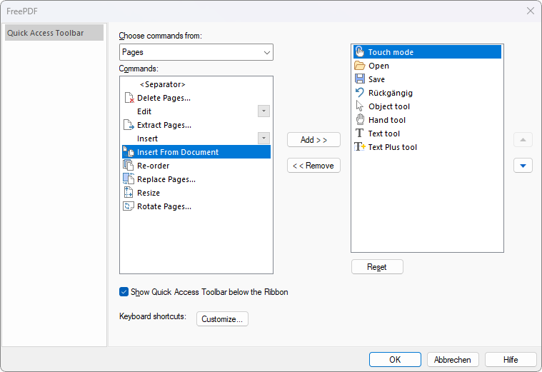

Adding/removing commands from the Quick access toolbar
Not only can you customize the default commands for the Quick access toolbar, but you can also choose from all other commands that are available in FreePDF. They can be added to the Quick access toolbar or removed again. To do so, proceed as follows:
1.Click on the black arrow to the right of the Quick access toolbar.
2.Select More Commands in the menu that appears.
3.The program will open a dialog box in which you can customize the commands for the Quick access toolbar.
dialog_quick_access_toolbar_free
4.In the dropdown list at the top left, first select the ribbon tab on which the command is located. The list below shows all commands of the selected ribbon tab.
5.Select the desired command in the list on the left and click on the Add button (or double-click on the command). The command will then be moved to the list on the right, where the existing commands of the Quick access toolbar are located.
You can use the Remove button, in turn, to remove a command from the Quick access toolbar after selecting it in the list on the right.
6.Use the buttons arrow_button_up and arrow_button_down if you want to change the position of the command within the Quick access toolbar. You can use a <Separator> from the list on the left to insert a separator line between commands and to group the commands in the Quick access toolbar more clearly.
7.Finally, click on OK.
Tip: You can also add commands to the Quick access toolbar without this dialog box by right-clicking on a command icon directly on a ribbon tab. The program displays a menu in which you select Add to Quick Access Toolbar.
To remove: Right-click directly on the command icon in the Quick access toolbar and select Remove from Quick Access Toolbar.
