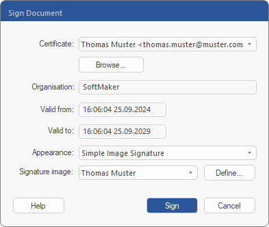

| 3. | After drawing the box, the dialog box "Sign Document" is displayed. |
| 4. | In the dropdown list Certificate, select the certificate that you want to use to sign the PDF file. |
| If you do not have a certificate (a PFX file), you can purchase one in various places on the Internet. You can buy a certificate from third-party providers or create your own free certificate (useful for test purposes). A search for "buy digital signing certificate" should return suitable results. |
| 5. | Click on the Browse button to add a new certificate to the list. |
| 6. | In the dropdown list Appearance, select how your signature should appear on the page. |
| More types of appearances will be added in future versions of the software. |
| 7. | Select an entry in the dropdown list Signature image. This is a scanned image of your handwritten signature. If the dropdown list is empty, you can now specify an image file by clicking on Define. For more information, see also Creating signatures. |
| 8. | Click on the Sign button and your signature will be almost complete. The final step is saving your PDF file. |
