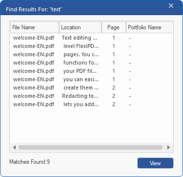

| 5. | Click on Find All if you only want to search. |
| The results window opens and displays a list of all search results. |
| Double-click on the result to open the file and display the search result. |
| Resize the columns in the list by dragging the individual separators between the header columns with the mouse. |
