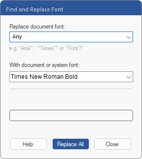

In both cases, the program displays the following dialog box:
dialog - replace fonts
3.Now, select one of the current fonts in the document from the dropdown list Replace document font.
You can also work with wildcard characters. For example, Time* finds all fonts whose names begin with Time, including Times New Roman, Times New Roman Italic, etc.
F? would find all font names with two digits, such as F0, F1, etc.
4.Next, select the replacement font from the dropdown list below it. You can either select a font that was used in the document or you can select a font that is installed on your computer.
For fonts in the document, it is important that you select a font which has all the characters (glyphs) required for the replacement. If this is not the case, FlexiPDF will issue a warning during replacement. For more information, see below.
5.Click on Replace All to start the process.

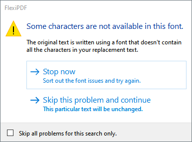

6.In some cases, a warning appears:
message - skip  Continue
This indicates that the selected replacement font does not have all the characters (glyphs) that are required for the text. You can now skip the replacement and continue or stop the process and try to remedy it by using a different font.
