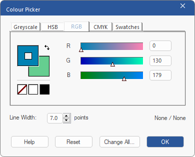

Via the dialog box "Color Picker"
If there are other objects besides drawings within the selection, you can change the line width via the dialog box Color Picker.
1.Select one or more objects with the Object tool icon_tool_object from the Quick access toolbar.
2.Choose the ribbon command Home | group Character | Font color icon_fontcolor. Click on the the arrow of the icon rather than on the icon itself in order to open its menu.
If you select More here, you will reach the dialog box Color Picker (which is described in detail in Changing color).
3.In addition to the fill and outline colors, the dialog box Color Picker also contains an input field for the Line Width further below. (In this case, it does not matter whether the outline box or the fill box is in the foreground.)
line-width
4.Enter a value for Line Width. A line with a thickness of 0 creates the thinnest line possible – thus it is not removed completely.
5.To completely remove an outline, set the outline color to 'invisible' by clicking on no-fill-stroke. For this purpose, however, the outline box must be in the foreground, as can be seen in the figure.
