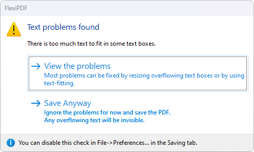

Problem report when saving
You may see a warning when you save a PDF:
font report warning dlg
Click on Save anyway to ignore the problems and save the PDF, or use View the problems to view the results as shown in the window below.

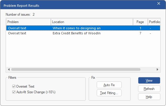

Problem Report Results
problem check report dlg
▪Double-click on a problem to view it in the PDF.
▪Click on the Filter checkboxes to show or hide different types of errors:
Overset text: If there is too much text to fit in a text box
Auto-fit Size Change >10%: If the text size was automatically adjusted by more than 10 percent to enable the text to fit in the box.
▪If you are making a change to the PDF (to resolve a problem), press Refresh to update the list of problems.
Solving problems that were identified in the problem report
To resolve problems, double-click on the relevant item in the list (or click on the View button). This selects the item in the PDF. You can now proceed as follows:
1.Resize the relevant text box to create more space for the text.
2.Edit the text to change its length.
3.Click on Auto Fix to apply the automatic text fitting. This slightly corrects the size of the text so that it fits in the text box. If this function is not available, it means that the automatic fitting has already been performed. In this case, click on Text Fitting.
4.The Text Fitting button enables you to change certain settings in order to achieve better text resizing.
Note: The specified automatic text fitting only applies to the selected text box.
