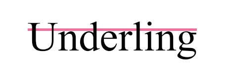

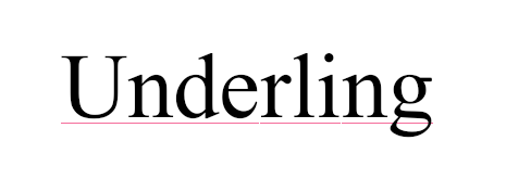

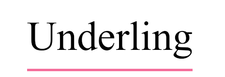

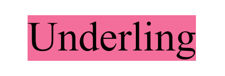

Examples of effects:
Offset -6 points
(for a 12 pt font size)
manual0071-00
manual0071-04
Offset +6 points
manual0071-012
manual0071-05
Weight 0 pt (hairline)
manual0071-02
manual0071-06
Text with background
manual0071-034
manual0071-07
