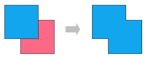

▪Union
This option creates a new common shape with a consistent outer contour of all selected shapes:

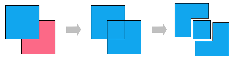

▪Fragment
New separate shapes are formed along the intersecting lines of overlapping shapes. These can then be moved individually – as shown on the far right in the following figure:
combine_objects_sample_c

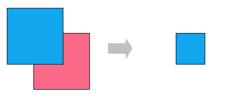

▪Intersect
This is the counterpart to Combine. Only the overlapping area is preserved, and the non-overlapping areas disappear:

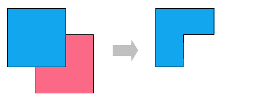

▪Subtract
The overlapping areas are removed from the first selected shape, and the following selected shapes themselves disappear:
