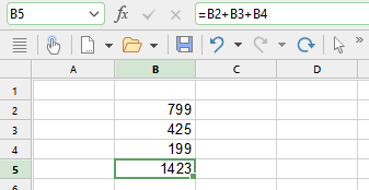

First, we enter the price of the computer; under that, the price of the monitor; and under that, the price of the printer.
Thus, navigate to cell B2 and type the value 799 there. The value will appear both in the selected cell and in the Edit toolbar above the worksheet.
Note: When entering numbers, do not make the mistake of typing the letter "O" or "o" instead of the number "0". PlanMaker makes a clear distinction between letters and numbers. The letter "O" is not a number for the program. PlanMaker would accept the input but interpret it as text, and thus could not perform calculations with it.
Then press the Enter key to complete your input. The cell frame automatically moves down one row to cell B3. Type the value 425 here and the value 199 in the row below.

Go to cell B5 and type an equal sign = at first. The equal sign shows PlanMaker that you would like to start entering a formula in this cell.
Then enter the formula. For this purpose, you use the cell addresses as "variables". Enter the following:
=B2+B3+B4
Note: Cell addresses are not case-sensitive, i.e., you can enter them in either uppercase or lowercase.
When you press the Enter key, you will immediately see the result of your first formula in the cell:

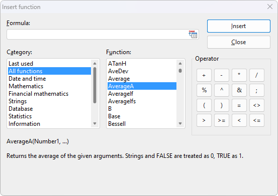

To get an idea of the multitude of computational functions available in PlanMaker, you can now choose the command Function.
You will find the command on the ribbon tab Formula | Function
or as Insert function with an identical icon in the Edit toolbar. Even faster: Simply press F7.
The program will now display a dialog box with a list of all functions that PlanMaker supports.
Tip: You can open a help page for each arithmetic function. Click on the desired function in the above dialog box, and then press the F1key.
Let's try another function. We'll calculate the average value of our three numbers in the worksheet:
To do so, exit the dialog box and delete the contents of B5 again.
Then choose the command Function (Insert function)
. Select the "All functions" category in the list on the left side of the subsequent dialog box. Then scroll down through the list on the right to the "Average" function. Double-click on the "Average" function.
In the input field Formula of the dialog box, PlanMaker has now automatically inserted the Average() row. To complete the formula, enter B2:B4 again between the parentheses.
Alternatively, you can simply select the desired cell range directly in the worksheet by left-clicking on cell B2 and then dragging the mouse down to cell B4. If the dialog box is covering the cells that you want to select, simply drag it out of the way while holding down the mouse button.
The completed formula should look as follows:
=Average(B2:B4)
If you click on Insert, this formula will be transferred to cell B5 and calculated immediately.
