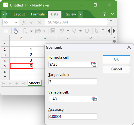

In the worksheet shown below, the SUM function has been used in cell A5 to add the numbers 1, 2 and 3 in the cells A2, A3 and A4. The result in cell A5 is 6. We now want to know to what value cell A3 must be changed so that the result of the addition is 7.
For this purpose, move the cell frame to the cell with the calculation whose result is to be changed – in this case, cell A5 with the SUM formula – and apply the goal seek.
goal_seek_sample
The figure illustrates how to fill in the values in the dialog box. When you click on OK, PlanMaker starts the approximation process and displays result 3 in a dialog box.
This means that the content of cell A3 must be changed from 2 to 3 so that the calculation has the result 7. If you click on Use in the dialog box, the value found will be applied to cell A3.
