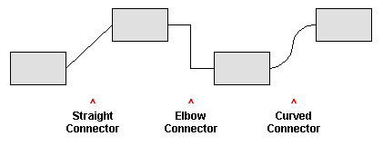

▪Connectors (straight, elbow and curved)
You can use these tools to drag connectors between two objects. The difference between the three types of connectors can be seen in the following figure:
connector_types_sample
To do so, select one of these tools, and then drag the mouse cursor from one object to another while holding down the mouse button. When you move the mouse cursor over an object, small blue rectangles will appear at various points on the object. These show where the line can "dock" to the object. You can influence the course of curved and angled connectors by dragging the diamond handle caro handles via the mouse.
Tip: You can change the type of connectors retroactively at any time. Right-click on the line to open the context menu and choose between a straight, elbow or curved connector. Also available in the context menu: The option Create new connector causes the shortest connection between two objects.
