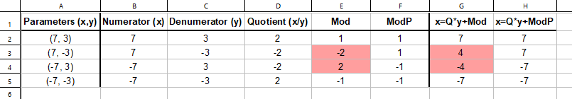

Microsoft Excel returns incorrect results when you use the MOD function with a negative numerator or denominator.
If you want to obtain correct results, you should use the MODP function described here instead of REST.
The following table shows the differences between MOD and MODP (the results highlighted in red color are incorrect):
modulo_sample
