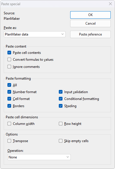

Pasting content via the dialog box with additional options
If you select the Paste special entry from Home | group Edit | Paste dropdown_arrow, the program displays a dialog box in which you can specify exactly how the content from the clipboard is to be pasted.
The dialog box displays a list of all formats in which the information currently on the clipboard is stored. If you select the desired format from the Paste as list and then confirm with OK, the content of the clipboard will be pasted in the selected format.
Furthermore, this dialog box offers several additional options, but they are only available if worksheet cells have been copied to the clipboard:
paste_special_dialog
The following additional options are available:
"Paste content" section
Here, you can specify how the content of the cells in the clipboard should be pasted:
▪Paste cell contents
If this option is enabled, the content of the copied cells will also be pasted. If it is disabled, only their formatting will be pasted.
▪Convert formulas to values
If this option is enabled, PlanMaker will paste the results of formulas in the copied cells rather than the formulas themselves. So if you copy a cell containing the calculation "=A1*2" to the clipboard, PlanMaker will calculate its current value and paste the result as a numeric value.
▪Ignore comments
If this option is enabled, comments that have been added to the copied cells will be omitted when pasting.
"Paste formatting" section
These options determine whether the formatting of the copied cells is to be retained when pasting:
▪All
The cells retain their entire formatting when they are pasted. (Selecting this option enables all the other options listed below.)
▪Number format
The cells retain their number format when they are pasted.
▪Cell format
The cells retain their cell format when they are pasted.
▪Input validation
The cells retain their input validation settings when they are pasted.
▪Conditional formatting
The cells retain their conditional formatting settings when they are pasted.
▪Borders, Shading
The cells retain their borders/shading when they are pasted.
"Paste cell dimensions" section
These options determine whether the cell sizes of the copied cells should also be transferred to the target cells when pasting:
▪Column width
The cells retain their column width when they are pasted.
▪Row height
The cells retain their row height when they are pasted.
"Options" section
This section contains the following additional options:
▪Transpose
If this option is enabled, the row and column order of the cells will be reversed when they are pasted. Thus, rows will become columns and columns will become rows.
▪Skip empty cells
If this option is enabled, all empty cells will be skipped when the copied cells are pasted. Thus, an existing cell will keep its current content and formatting if you paste an empty cell over the existing cell.
▪Operation
This option can be useful when you paste cells over existing cells. It determines whether the existing values should be combined with the copied values. For this purpose, the four basic arithmetic operations are available:
None: Do not combine the copied values and the existing values. Just overwrite the existing values. This is the default setting.
Add to destination: Add the values in the clipboard to the existing values.
Subtract from destination: Subtract the values in the clipboard from the existing values.
Multiply with destination: Multiply the existing values by the values in the clipboard.
Divide the destination: Divide the existing values by the values in the clipboard.
Example: Copy a cell that contains the value 2 to the clipboard. Then select a cell that contains the value 8, and choose the command Home | Paste dropdown_arrow | Paste special. If you choose the option Add to destination in the dialog box, the cell will then contain the value 10 (8+2=10).
