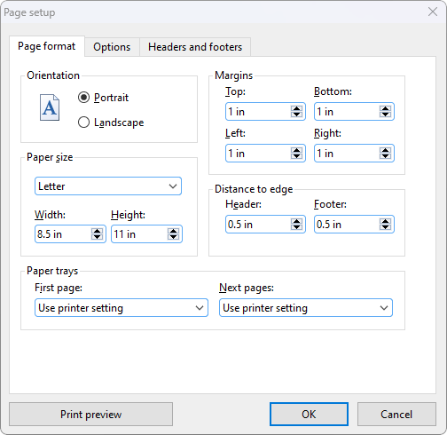

Applying via the dialog box of the command group "Page setup"
On the ribbon tab Layout | group Page setup, click on the group arrowgroup_arrow in the lower right corner to open the dialog box and switch to the Page format tab.
Alternatively, you can open the dialog box with the ribbon command File | group Print | Page setup.
page_setup_dialog_a
Then make the desired settings:
▪Orientation
Here, you can specify the Orientation of the document on the printed page: Portrait or Landscape.
▪Paper size
You can specify the paper size for the printed pages here. The dropdown list Paper size contains all paper sizes that are supported by the current printer. If you want to specify a size that is not listed, you can do so by manually specifying values in the fields Width and Height.
▪Margins
You can set the page margins here.
▪Distance to edge
Here, you can determine how much space should be left between headers and footers and the upper or lower edge of the sheet.
Note: Headers and footers are always printed at the top and bottom of the page, respectively. If they do not appear on the printout, check whether a) the Distance to edge is too large or b) the top/bottom margin is too small.
▪Paper trays
Only available in Windows version: If your printer has multiple paper trays, you can set the tray which the printer should use. If you have selected the default setting Use printer setting, PlanMaker does not affect the paper feed. If, for example, you want the first page of your document to be printed on paper from tray 1 and the remaining pages on page from tray 2, you should change this setting accordingly.
