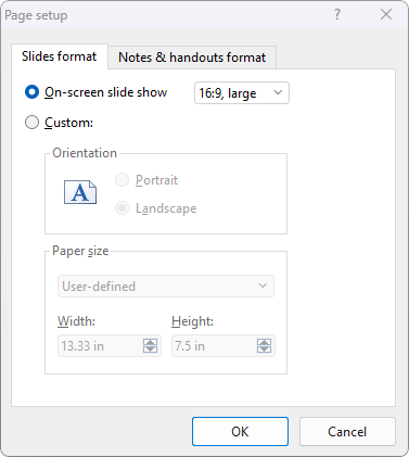

Additional options: Via the dialog box "Page setup"
Open the dialog box "Page setup" as described above (alternatively: via the ribbon command File | group Print | Page setup).
The dialog box has two tabs, one for setting up the slides and the other for notes and handouts:
page_setup_dialog
The Slides format tab of the dialog box has two options from which to select. If you select the option On-screen slide show, you can choose between a number of predefined slide formats for on-screen slide shows (4:3, 16:9, etc.) to the right of this option. The orientation of the slides is always set to landscape. If you would like to change the orientation, select the option Custom. The Orientation and Paper size sections are now enabled and you can switch between portrait and landscape.
The Paper size settings can be used to resize the slides or printouts. The dropdown list contains the most common paper sizes. If you need a different size, you can also specify the values for Width and Height individually.
Note: If you change the orientation or the paper size, Presentations asks whether all objects on all slides should be scaled accordingly. If you want to keep the object sizes, click "No" here.
On the Notes & handouts format tab, you can also set whether you want to use the printer's default paper format for Notes and Handouts or customize the values to suit your needs.
