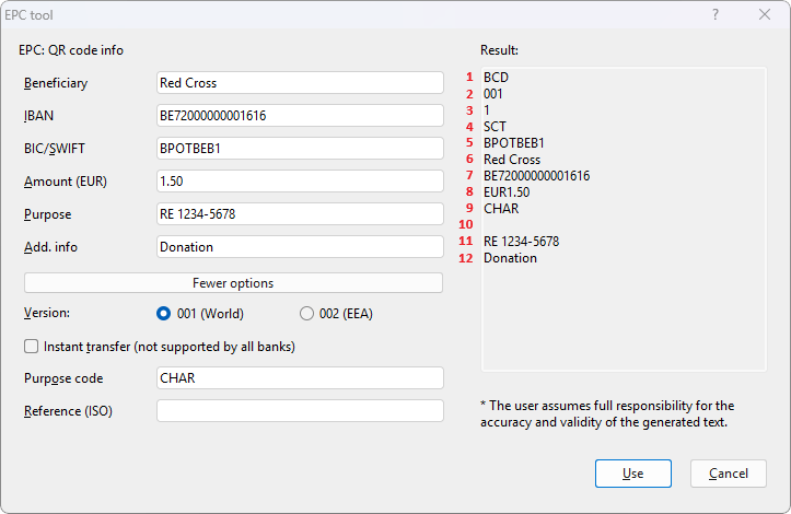

EPC_QR_Code_dialog
4.On the left side, enter the transfer details. On the right side, you will see the result of your entries – in the correct form and sequence for scanning the multiple-line EPC QR code.
If you click on the More options button, you will find more input fields. However, it is usually sufficient to just use the fields that are located above the button.
Note: Not all fields must be filled in, as there are fields with optional entries (see table below). In addition, the top two entries that you see in the "Result" list on the right are preset by Presentations and thus do not need to be entered in the mask.
Explanations of the input fields and their position in the 12-line result can be found in the "Scheme of the EPC QR code" table below.
5.Once you have entered all the data, click on the Use button. Your data will be used to generate the QR code and you can complete the creation in the main window.
The multiple-line text for an EPC QR code can only be scanned by the banking app in a predefined format. On the right side of the Presentations input mask, you can already see the result of the data in the correct form and sequence for scanning a multiple-line EPC QR code.
The following table shows the meaning of the input fields and the corresponding line in the result:
