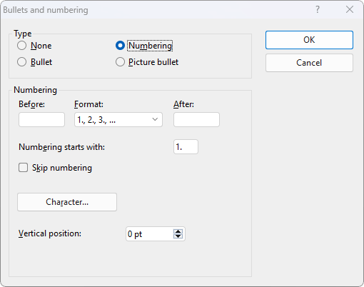

Other options: Via the dialog box "Bullets and numbering"
To insert custom numbering, you will find additional options in the dialog box.
Proceed as follows:
1.Select the relevant paragraphs.
2.Click on the arrow next to the icon numbering_icon on the ribbon tab Home | group Paragraph. In the dropdown menu, select the entry Format numbering.
3.In the following dialog box, select the option Numbering under Type.
numbering_dialog
4.Make the desired settings for numbering if required. (For more information, see the "Options of the dialog box" section below.)
5.Confirm with OK.
The selected paragraphs are now numbered.
In the above dialog box, you can make the following settings for numbering:
▪Type
Here, you can specify either numbering or bullets for the selected paragraphs. Select the Numbering option for numbering.
Note: You can always convert a numbered list into a bulleted list simply by changing the "Type" to Bullet. You can also do it the other way round, of course.
If you set the type to None, existing bullets or numbers are removed.
▪Before and After
If required, you can specify text to be added before and/or after the number assigned to the paragraph. If, for example, you want the numbers to be surrounded by dashes (-1-, -2-, -3- etc.), select the Format "1, 2, 3, ..." and enter "-" in the Before and After fields.
▪Format
Here, you specify the format for the numbering. In addition to the usual "1., 2., 3., ...", you can select letters (A, B, C, ...) or Roman numerals (I, II, III, ...).
▪Numbering starts with ...
Presentations starts every numbered list at "1" by default. If you want to use a different start value, enter "5" here, for example, and the numbering will start at "5".
Tip: Furthermore, you can also do the following: If, for example, you have set the numbering a, b, c, etc., for the above option Format and have entered the start value "aa", you create numbering like aa, bb, cc, etc.
▪Skip numbering
Within a numbered list, you often require one or more paragraphs for which the numbering is to be temporarily suspended but then resumed for the following paragraph. To do so, position the text cursor in the numbered paragraphs that you want to exclude from the numbering, and select the option Skip numbering.
▪Character button
You can click on this button to change the character formatting (font and font size, text styles, etc.) for the numbers.
▪Vertical position
This option allows you to specify the vertical position of the numbers. If the value is negative, the number is positioned lower. It is positioned higher if the value is positive.
