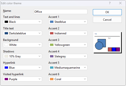

Editing color themes
It is also possible to edit the predefined color themes and customize them according to your individual needs. To do so, proceed as follows:
1.Select a color theme from the menu of the command Colors color_schemes_icon_18. As a result, it becomes the current color theme.
2.If you open the menu of the command again, you will now see the selected color theme listed at the very top as the currently active one.
3.Click on the pencil icon color_schemes_pencil_icon to the right of the color theme. Alternatively, you can also select Edit theme at the bottom of the menu.
4.The dialog box "Edit color theme" opens.
color_scheme_edit_dialog
5.You can now change the colors of the different elements as you like. To do so, open the corresponding dropdown list and select the desired color. The thumbnail in the bottom right corner of the dialog box shows the currently set colors.
The entry More colors at the end of the dropdown lists allows you to apply user-defined colors; see "Working with the color controls" above.
Tip: If you change the name in the Name field, the color theme is saved as a new custom theme.
6.Click on OK to confirm the changes to the color theme.
Note: Changed color themes are only saved in the current document and are not available in other documents.
