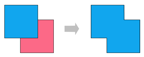

▪Union
This option creates a new common shape with a consistent outer contour of all selected shapes:

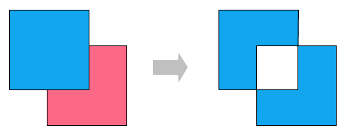

▪Combine
The non-overlapping parts of the shapes are preserved, while the overlapping areas become transparent:

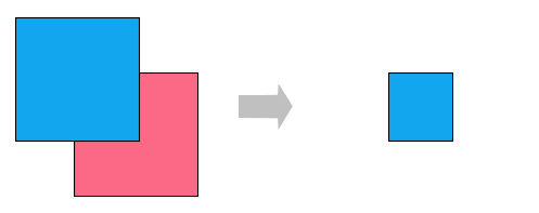

▪Intersect
This is the counterpart to Combine. Only the overlapping area is preserved, and the non-overlapping areas disappear:
combine_objects_sample_d

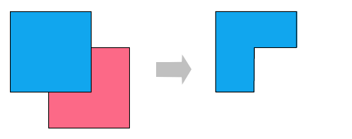

▪Subtract
The overlapping areas are removed from the first selected shape, and the following selected shapes themselves disappear:
combine_objects_sample_e
