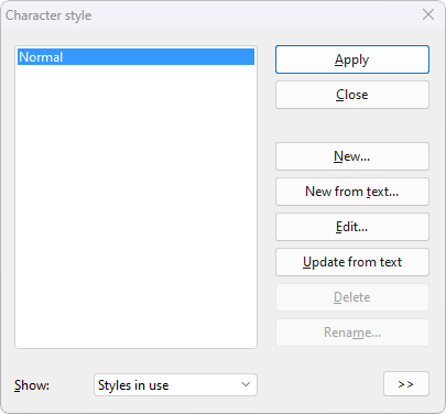

1.At the top of the Sidebar, click on the sidebar_character_icon icon for the "Character styles" sidebar and select the entry Character style via the Organize button.
The following dialog box opens:
character_styles_dialog
2.In the list on the left side of the dialog box, select the style on which you want your new character style to be based. In the event of doubt, use the "Normal" style.
Note: The style of the section of text in which the text cursor was located before choosing the command Character style is always preselected here in the dialog box. For information on changing the style basis – even afterwards – see "Based on" character styles.
3.Then click on the New button.

Creating character styles from existing text
Alternatively, you can first format some text as desired and then create a new style that assumes this exact formatting. For this purpose, use the New from text button instead of the New button.
This procedure is useful if you have previously formatted text manually and want to have a character style that has exactly the same character formatting.
To do so, proceed according to the following detailed steps:
1.Apply the desired character formatting (font, font size, etc.) to a section of text.
2.Place the text cursor in this section of text or select it as both options work equally well.
3.Create a new character style via the command Character style as described above. Important: Use the New from text button in the dialog box now instead of the New button.
