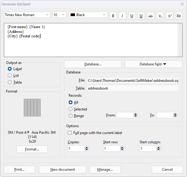

You can use the ribbon command Mailings | group Create | List/Label db_list_label_icon to create lists and labels of all kinds with minimal effort. This command is primarily intended for creating address labels. The corresponding addresses should be available in the form of a database. (For basic information on working with databases, see the first sections of Database.)
db_list_label_dialog
In addition to labels, you can also use this command to create lists and tables with the data of a database. The differences are as follows:

Working with lists and labels is easy: If you want to create, for example, address labels, choose the aforementioned command. In the dialog box that appears, first specify the database to use (i.e., the database containing the addresses). Then insert the desired database fields into the large input field – just as they should appear later on the label (see screenshot above). Finally, select the label format from a predefined list of labels of many manufacturers. Done! Printing can begin.

2.Under Output as, select what you want to create: Label, List or Table. In our example, you would select Label.
3.If you want to display the contents of a database in the label: Click on the Database button and select the desired database – for example, the supplied address database addressbook.sqlite.
4.The large input field in the upper part serves as a "mask" for the content of the label. Enter the desired content there – just as you want it to appear on the label later. You can insert database fields as well as ordinary text and combine them to your liking.
To insert database fields, it is best to use the Database field button. A list of all fields in the database will be displayed. If you click on one of the fields, it will be inserted at the current position of the text cursor.

5.For labels, you now need to click on the Format button and set the format of the labels that you want to print. The button opens another dialog box where you can select the manufacturer and product number of the label from predefined lists.

▪Large input field
In the large input field at the top of the dialog box, enter the desired content for the label (or list/table) – just as you want it to appear later on the label. The screenshot at the beginning of this section shows an example.
You can add text by simply typing it in.
You can also insert database fields (if you selected a database using the Database button). To insert a field, click on the Database field button and then select the desired field. Alternatively, simply type the field's name enclosed within curly braces (for example, {City}).

Only for labels: Here, you can see which label format is currently selected (manufacturer, product name, number of rows/columns).
Note: The format must be large enough to fully accommodate the content of the label. Otherwise, the content will not appear completely in the subsequent printout.
To select a different format, click on the Format button and select the label's manufacturer and product name from the lists. If required, you can also set the margins to be left blank on each (individual) label.

▪"Database" button
Lists and labels are often used to output the contents of a database. If you click on the Database button, you can specify which database this should be – for example, the supplied address database addressbook.sqlite.
▪"Database field" button
This option is used to insert database fields. Clicking this button opens a list of all database fields available in the selected database. If you click on one of these fields, it will be inserted into the large input field in the dialog box.

Here, you can also specify which database records are to be used: All, only Selected (see Selecting records for a mail merge) or a Range of records that you can specify by entering the first and last record numbers.

Label:
You can make the following settings for the output of labels:
Full page with the current label: If you enable this option, a whole sheet of labels, containing identical copies of the label, will be output for each individual label. This is useful for simple labels with fixed text (without using a database) if you want to print whole sheets of one label at once.
Copies: Here, you can set how many copies of each label should be output.
Start row and Start column: Here, you can specify in which row and column of the first label sheet the output should start. This is useful when reusing label sheets where some of the labels have already been printed.
