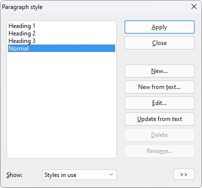

To create a paragraph style, proceed as follows:
| 1. | On the ribbon tab Home | group Styles, choose the command Paragraph style. |
| The following dialog box opens: |
| 2. | In the list on the left side of the dialog box, select the style on which you want your new paragraph style to be based. In the event of doubt, use the "Normal" style. |
| Note: The style of the section of text in which the text cursor was located before choosing the command Paragraph style is always preselected here in the dialog box. For information on changing the style basis – even afterwards – see "Based on" paragraph styles. |
| 3. | Click on the New button in the dialog box. |
| 4. | Give the paragraph style whatever name you like. |
| 5. | The program will display a dialog box which is very similar to the dialog box for the command group Home | Paragraph. Here, you can specify the desired paragraph formatting. For more information, see Paragraph formatting. |
| 6. | If you will need this style frequently, you can assign a shortcut key to it (see below). |
| 7. | When you have made all desired settings, click on OK in the dialog box Paragraph to create the style. |
| 8. | Exit the dialog box Paragraph style with Close. |
