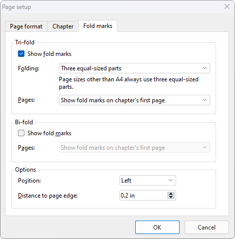

Click on the group arrow
in the bottom right corner of the ribbon tab Layout | group Page setup to open the dialog box and switch to the Fold marks tab.
The dialog box contains the following options:
Tri-fold section
With tri-fold marks, you place a top and bottom mark in your document to indicate how to fold it. To do so, enable the checkbox Show fold marks in the Tri-fold section.
From the two lists below, select the distances at which the fold marks should be placed on the page and on which pages they should appear.
▪In the dropdown list Folding, you can choose between the following vertical distances:
| Three equal-sized parts: The fold marks divide the page into equal distances. This option is recommended; the other two options are mainly of interest to users who adhere to the DIN standards that are common, for example, in Germany. |
| A4 pages: small part on top (DIN type A): The fold marks divide the page into the distances 87 / 105 / 105 mm when viewed from the top edge of the page (form A according to DIN 5008). |
| A4 pages: large part on top (DIN type B): The fold marks divide the page into the distances 105 / 105 / 87 mm when viewed from the top edge of the page (form B according to DIN 5008). |
Note: If the paper size on the Page format tab is set to an option other than A4, fold marks are always automatically placed on the page as three equal-sized parts.
▪In the dropdown list Pages, you specify on which pages fold marks should appear:
| on the first page, on odd pages, on even pages or on all pages of the document. (A document that has not been divided into chapters is simply treated as a single chapter.) |
| If you have divided your document into chapters, the selection only applies to the selected chapter and not to the entire document. If you thus want to apply the selection to all chapters, you also have to select all chapters beforehand. |
Bi-fold section
With a bi-fold mark, you apply a central mark as an orientation point for punching a hole in the document. To do so, enable the checkbox Show fold marks in the Bi-fold section.
In the dropdown list Pages below it, specify the pages on which the bi-fold marks should appear:
Options section
▪Position
| Here, you can select whether the tri-fold/bi-fold marks should appear on the left, right or on both sides. |
▪Distance to page edge
| To change the lateral distance of the tri-fold/bi-fold marks, enter the desired value here or use the arrow keys. |
