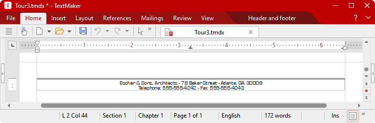

First select and then center both footers with the icon paragraph_align_center on the ribbon tab Home | group Paragraph so that the footers ultimately look as follows on the screen:
tour_3_sample
To get back to the normal text after setting up the footers, simply click on any position in the text with the mouse. If you subsequently want to edit the footers again, all you have to do is click again with the mouse on one of the footers.
