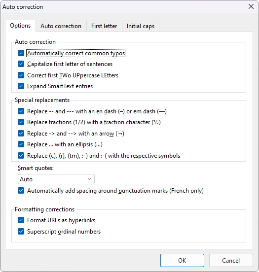

You can adjust the auto correction settings according to your needs.
Note: Auto correction is a global setting. Changes you make here will thus be applied to every document.
To do so, choose the ribbon command Review | group Spelling | Auto correction autocorrect_icon, and the following dialog box will appear:
autocorrect_dialog_options
On the Options tab, you will find the following auto correction functions:
"Auto correction" section
▪Automatically correct common typos
This option ensures that typical typing errors are corrected. If, for example, you type "thier", TextMaker automatically corrects this word to "their".

"Special replacements" section
TextMaker can trigger some special characters automatically as soon as you type a certain combination of characters in your text. For example, three dots in a row ("...") are converted to ellipsis points. Enable or disable the desired options in this section.

Smart quotes
TextMaker can automatically convert double quotes (") and single quotes (') as they are typed to ensure that they are typographically correct for the selected language. Here, set the desired language or select "None" if you want TextMaker to leave your quote marks unchanged.
If, for example, you type "Text" or 'Text', the relevant setting will produce the following results:

"Formatting corrections" section
▪Format URLs as hyperlinks
If this option is enabled, URLs (web page addresses) are automatically formatted as hyperlinks immediately after entering them.
If, for example, you type "www.softmaker.de" in the text, it will automatically be converted into a clickable hyperlink and displayed accordingly (usually blue and underlined).
