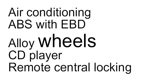

At least
This figure illustrates how the At least mode works. This mode lets you specify the minimum space FreePDF should leave between the lines (measured in points).
To prevent the line with the word "wheels" from colliding with the line above it, FreePDF automatically increases the line space.
manual0078-01

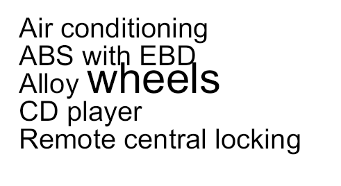

Exactly
This figure illustrates how the Exactly mode works. This mode allows you to set the line space exactly (measured in points).
FreePDF always uses the exact same line space for all lines, even if lines collide with each other.
manual0078-02
