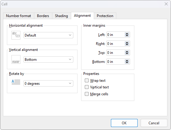

Aligning via the dialog box of the command group "Alignment"
You open the dialog box on the ribbon tab Home by clicking on the group arrowgroup_arrow in the bottom right corner of the command group Alignment. In the dialog box, you will find additional options that cannot be set directly via the icons of the command group Alignment as described above (for example, Inner margins).
alignment_dialog
The dialog box contains the following options on the "Alignment" tab:
Horizontal alignment
This determines the horizontal alignment of the cell content within the cell boundaries:
Default: Text left-aligned, numbers right-aligned, and logical values and error values centered
Left: Align the cell content with the left edge of the cell
Centered: Align the cell content horizontally with the center
Right: Align the cell content with the right edge of the cell
Justified: The cell content is evenly distributed between the left and right cell border (only affects cells that contain multiple lines of content and have the option Wrap text enabled)
Center across columns: The content of one cell is centered across multiple columns. For this purpose, select the cell and any number of adjacent cells to the right of it (these cells have to be empty!). Then select the Center across columns alignment.
Vertical alignment
This determines the vertical alignment of the cell content within the cell boundaries:
Bottom: Align the cell content with the bottom edge of the cell
Centered: Align the cell content vertically with the center
Top: Align the cell content with the top edge of the cell
Justified: The cell content is evenly distributed between the top and bottom cell border (only affects cells that contain multiple lines of content and have the option Wrap text enabled).
Rotate by ...
Here, you can rotate the entire cell (including its contents) around the selected angle.
Text direction
For text in Arabic script, you can change the text direction of the cell to right-to-left here. If you select the default setting Context-sensitive, PlanMaker sets the correct writing direction automatically.
For more information, see also Working with Arabic text.
Inner margins
Here, you set the inner margins of cells.
Line break
If this option is enabled, the cell content will be automatically wrapped to the next line if the cell width is insufficient to display it in a single line.
By default, this option is disabled.
Tip 1: You will also find this option via the context menu by right-clicking on a selected cell.
Tip 2: You can use the key combination Alt+Enter to wrap to the next line manually.
Vertical text
If this option is enabled, the cell content will be displayed vertically (top to bottom instead of left to right).
Merge cells
This option lets you merge a cell with adjacent cells. To do so, select the cell and any number of directly adjacent cells and enable this option.
PlanMaker treats merged cells as if they were one single cell.
Note: Whenever you merge cells, all cells except the upper left cell lose their contents.
To split merged cells, select them again and disable this option.
