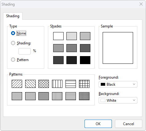

Other options: Via the dialog box
The dialog box contains additional shading options. The option Shades allows you to mix colors individually, and you can also apply different Patterns in the dialog box.
You open the dialog box by clicking on the arrow of the icon cell_shading_icon and choosing More in the dropdown menu.
Alternatively: On the ribbon tab Home | group Alignment, click on the group arrowgroup_arrow and switch to the Shading tab.
cell_shading_dialog
In the dialog box, proceed as follows:
1.Select the desired cells.
2.On the ribbon tab Home | group Alignment, click on the group arrowgroup_arrow for the dialog box and switch to the Shading tab.
3.Apply the desired shading (see below).
4.Confirm with OK.
You can choose between the following types of shading:
▪Adding a shade
A shade is a color shading that is mixed from the selected foreground color and background color.
To add a shade, set the Type to Shading and then make the desired settings:
First, set the desired Foreground and Background colors. (The background color is set to white by default.)
In the section Shades, different mixtures of these two colors are now offered. Select one of these suggestions. Alternatively, you can enter an exact percentage for the shade in the input field under Shading. Values between 0 (100% background color) and 100 (100% foreground color) are allowed.
▪Adding a pattern
To add a pattern, click on one of the patterns in the section Patterns.
You can also select a different Foreground and Background color for the pattern.
▪Removing a shade or pattern
If you want to remove existing shades or patterns, select None for Type.
Then confirm with OK.
