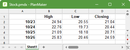

chart_type_stock  Stock chart
Stock charts (also known as general high-low charts) are suitable for displaying the development of stock prices, among other things. They enable the highest price, lowest price and closing price to be seen at a glance, for example.
The following subtypes are available:
▪Stock chart (High, Low, Close)
This type of chart displays the following values: highest price, lowest price, closing price.
It requires 3 data series in the above order.
An example of the possible structure of the data (with the date added in column A):
