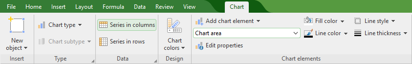

ribbon_tab_object_chart_a
The contextual ribbon tab "Chart", left section

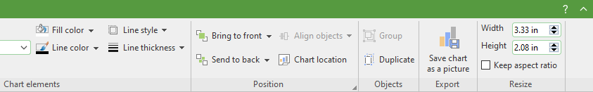

ribbon_tab_object_chart_b
The contextual ribbon tab "Chart", right section
This ribbon tab contains icons for the most important functions for editing charts:
▪New object: This option allows you to insert a new object into the document, and different object types are available.
▪Chart type/Chart subtype: This option allows you to select a chart type. (A subtype is only available for some chart types.) For more information, see Changing the chart type.
▪Series in columns/rows: This option allows you to specify whether the data to be displayed should be evaluated column by column or row by row. For more information, see Changing the arrangement of data series.
▪Chart colors: This option allows you to change the color scheme of the chart.
▪Add element: This option allows you to show or hide chart elements such as axis titles, gridlines, legends, etc. For more information, see Showing/hiding chart elements.
▪List of all chart elements contained in the chart. If you click on an element in the list, it will be selected in the chart – if you select an element in the chart, it will be displayed in the list.
▪Edit properties: You click on this option to edit the selected chart element and the corresponding dialog box opens. For more information, see Editing chart elements.
▪Fill color, Line color, Line style, Line thickness: You can use these options to change the fill and border lines of the selected chart elements. For more information, see Editing chart elements.
▪Bring to front, Send to back: These options allow you to arrange the order of overlapping object frames. For more information, see Changing the order of objects.
▪Align objects: This option allows you to align or evenly distribute two or more object frames. For more information, see Aligning and distributing objects.
▪Chart location: For more information, see Moving charts to another worksheet.
▪Group: This option allows you to combine several selected objects into one unit, which can then be treated like a single object. For more information, see Grouping objects.
▪Duplicate: This option allows you to create an immediate copy of the selected chart.
▪Save chart as a picture: This option allows you to save an image of a chart as a picture file. For more information, see Saving charts as pictures.
▪Width, Height: These options change the size of the chart. For more information, see Changing position and size of objects.
