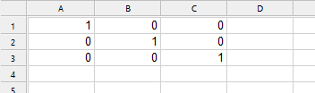

MUNIT(3) returns the following 3x3 unit matrix for cells A1-C3.
munit_matrix sample

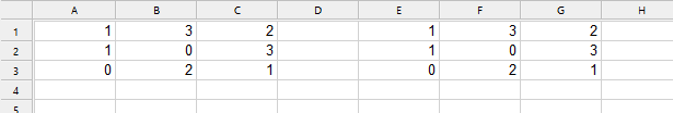

For example, combine the MUNIT function with the MMULT function to multiply two matrices. Cells A1:C3 contain values from an array. If you enter the formula below in cell E1, you will get the following result:
MMULT(A1:C3, MUNIT(3))
munit_mmult_matrix sample
