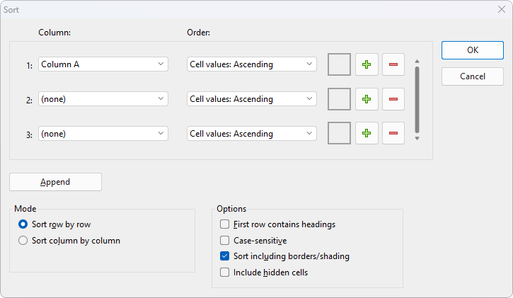

You can choose the ribbon command Sort to open a dialog box with additional sort options.
Proceed as follows:
1.Select the cell range to be sorted.
2.Choose the ribbon command Data | group Filter | Sort sort_general_icon.
3.PlanMaker opens the following dialog box:
sort_general_dialog
4.For 1:, select the Column by which you want to sort.
5.To the right of it, you can also change the Order of the sort: You can sort the cell values in Ascending (A to Z) or Descending order (Z to A).
Note: If different shades or font colors have been applied to cells, they can also be sorted. See "Sorting cells by shading or font color" below.
6.If required, you can select additional columns by which to sort for 2: and 3:.
If, for example, you select a column containing family names for 1: and a column with first names for 2:, the cell range will be sorted by the family name and then, in groups of identical family names, by the first name.
7.Make any further settings as required, see below.
As soon as you confirm with OK, the cell range will be sorted accordingly.

The dialog box offers the following options:
▪Column and Order
Here, select the desired Column(s) by which to sort. You can also specify the order for each column: Ascending goes from A to Z, and Descending goes from Z to A for the cell values.
Up to 3 columns can be specified by default. You can even add additional columns if you need more than 3 sort criteria. Up to 64 columns are possible. Proceed as follows:
Add a column: Click on the Plus icon to insert another column.
Append a column: Click on the Append button (below the list) to append a column at the bottom.
Remove a column: Click on the Minus icon to remove the respective column. (This only works if there are more than 3 columns.)
▪Sort row by row or Sort column by column
These options determine whether PlanMaker sorts by row or by column.
▪First row contains headings
If the first row or column of the selected cell range contains a heading, you should enable this option. PlanMaker then omits it from the sorting.
Example:
You have selected a list of addresses that you want to sort by row. The first row of your selection contains headings such as "Name", "Street", "City", etc. The actual addresses are in the rows below. You should enable this option so that this row is not sorted and remains the first row.
▪Case-sensitive
If you enable this option, sorting distinguishes between uppercase and lowercase letters. For example, all words that begin with a lowercase letter end up in front of the words that begin with a capital letter:
Disabled: Apples, bananas, Cherries. Enabled: bananas, Apples, Cherries.
▪Sort including borders/shading
If this option is enabled, cells retain their assigned borders and shading when moved by the sorting operation.
If disabled, the selected cell range keeps its original formatting as far as borders and shading are concerned.
▪Include hidden cells
If the selected range contains cells that have been hidden (see Showing and hiding rows/columns), these are usually not sorted. Enable this option if you want hidden cells to be included in the sort.
