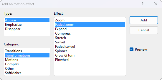

...whereupon another dialog box appears with all available animations:
animation_effects_dialog
In the list Type, you can select the type of effect as follows:

Each of the effect types has a number of categories which are listed in the list Category. Each category, in turn, contains many effects that are listed in the list Effect.
To choose an effect, first select the Type, then the Category and finally the specific Effect.
If you have enabled the option Preview, you can view the animations directly in the slide while clicking on an effect in the dialog box. This enables you to quickly find a suitable effect.
Use the Add button to apply your selection.
