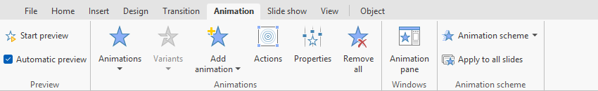

To add an animation to an object, select the object (also possible for placeholders).
Then choose the command Animations animations_icon on the ribbon tab Animation.
ribbon_tab_animation
In the dropdown menu of the command Animations, you can choose from various types of effects:
▪Appear effects make an object fade onto the slide.
Example: The object "flies" into the slide.
▪Emphasize effects change the appearance of the object in order to emphasize it.
Example: The object flashes briefly in a different color or size.
▪Disappear effects make the object disappear from the slide.
Example: The object "flies" out of the slide.
To remove an effect from the selected object, choose None from the dropdown menu. The entry More animations opens the dialog box with additional categories of animation effects. For more information, see Applying object animations via the dialog box. (Note: These additional categories can also be found via the sidebar. For more information, see the description below.)
Some animations also have different available variants animations_variants_icon, which you can select via this button if necessary. In this case, the icon appears colored.
What is the difference between the buttons Animations animations_icon and Add animation animations_add_icon?
The command Animations is usually used to initially apply an animation effect to an object. When you use this command again, you can replace the existing effect with another effect for this object. However, you use the command Add animation to add an additional effect to this object. Thus, a sequence of different effects is possible for the same object.
Further commands on the ribbon tab "Animations":
▪Automatic preview: If this option is enabled, the effect is demonstrated immediately on the slide when you hover over it in the dropdown menu of the ribbon commands Animations or Add animation. This makes it easy to find a suitable effect.
▪Start preview: With this command directly above it, you can check the animation for the selected object by starting it at any time after applying an effect.
Note: If you select multiple objects, all animations for those objects will be played in succession. If no object is selected (click on the slide), all animations of the slide will be played in succession.
Tip: In the mini sorter, slides that have an effect are indicated with a little arrow icon slide_transition_mini_icon in their top left corner. If you click on this icon, you can also preview all effects in the thumbnails.
▪Actions: Use this command to assign an action to an object. This is executed when running the slide show – either when clicking on this object or when the mouse is positioned over it. For more information, see Adding object actions.
▪Properties: This allows you to subsequently edit the properties of the animation effect used, for example, options for starting an animation or its timing. For more information, see Animation properties in detail.
▪Remove all: This command removes all animation effects from the current slide.
▪Animation pane: This option enables (or disables) the sidebar with additional options for animation effects. To use the sidebar for object animations, see the description below.
▪The command group Animation scheme: Animation schemes allow you to apply slide transitions and matching object animations. For more information, see Slide animation schemes.
