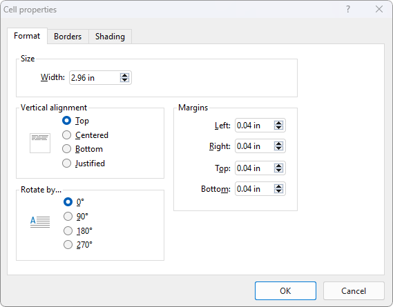

Additional options: Via the dialog box
You open the dialog box with the ribbon command Table | Properties dropdown_arrow | Cell.
tables_cell_properties_dialog
The dialog box contains the following options:
Format tab
This tab provides the following settings options:
▪Size
Here, you can change the Width of the selected cells.
Note: The width of the entire column always changes. You cannot set the width separately for individual cells in a column.
Tip: You can also change the width with the mouse. To do so, drag the side border of the cell with the mouse. This always adjusts the width of the entire column also.
▪Vertical alignment
This setting determines how the cell contents should be aligned within the cell:
Top: The cell content will be aligned to the top edge of the cell. (This is the default setting.)
Centered: The cell content will be centered between the top and bottom edges of the cell.
Bottom: The cell content will be aligned to the bottom edge of the cell.
Justified: The lines of text within the cell will be equally spaced in such a way that the top line will be flush against the top edge of the cell and the bottom line flush against the bottom edge.
▪Rotate by...
Here, you can specify the angle of rotation for the cell content.
▪Margins
Here, you can change the inner margins of the selected cells.
