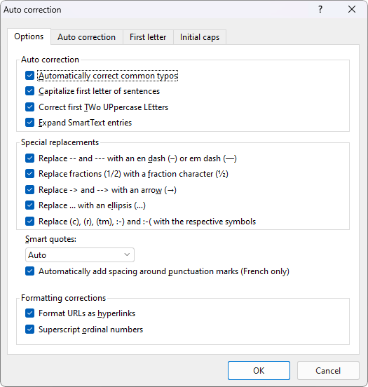

You can adjust the auto correction settings according to your needs.
Note: Auto correction is a global setting. Changes you make here will thus be applied to every document.
To do so, choose the ribbon command Slide show | group Review | Auto correction autocorrect_icon, and the following dialog box will appear:
autocorrect_dialog_options
On the Options tab, you will find the following auto correction functions:
"Auto correction" section
▪Automatically correct common typos
This option ensures that typical typing errors are corrected. If, for example, you type "thier", Presentations automatically corrects this word to "their".
A list containing common typos is pre-installed for some languages. You will find this list on the Auto correction tab, where you can delete existing pairs of terms or add new ones. For more information, see Auto correction tab.
▪Capitalize first letter of sentences
If this option is enabled, Presentations automatically capitalizes the first letter of every sentence you type – even if you accidentally enter a lowercase letter.
If, for example, you typed the sentence "this is a new sentence.", it would be corrected automatically to "This is a new sentence.".
Exception list: For certain terms, however, it may be undesirable for this automatic correction to occur (for example, after an abbreviation such as "max."). Switch to the First letter tab, where you can add terms that should be excluded from this correction. For more information, see First letter tab.
▪Correct first TWo UPpercase LEtters
If this option is enabled, Presentations automatically corrects the case of words whose first two letters have been capitalized inadvertently.
If, for example, you typed the word "HEnry", it would be corrected automatically to "Henry".
Exception list: If, however, you want to exclude certain expressions from this correction (for example, "BSc"), then switch to the Initial caps tab. Here, you can add terms where two capital letters at the beginning should not be corrected. For more information, see Initial Caps tab.
▪Expand SmartText entries
As described in SmartText, you can use Presentations to create SmartText entries (for example, "sd" for "sales department").
If this option is enabled, your SmartText entries can be directly expanded as the text is entered. To do so, simply type the abbreviation for the SmartText entry (for example, "sd") and then a space, Enter or a punctuation mark, and Presentations will automatically replace the abbreviation with the SmartText content.
If this option is disabled, however, SmartText entries can only be inserted via the dialog box of the ribbon command Insert | group Text | SmartText.
Tip: The option "Expand SmartText entries" can also be enabled or disabled in this dialog box.
"Special replacements" section
Presentations can trigger some special characters automatically as soon as you type a certain combination of characters in your text. For example, three dots in a row ("...") are converted to ellipsis points. Enable or disable the desired options in this section.
Tip: On the ribbon tab Insert | group Text you can use the commands Character and Symbol to find other common characters and symbols that you can insert manually into your text.
Smart quotes
Presentations can automatically convert double quotes (") and single quotes (') as they are typed to ensure that they are typographically correct for the selected language. Here, set the desired language or select "None" if you want Presentations to leave your quotes unchanged.
If, for example, you type "Text" or 'Text', the relevant setting will produce the following results:
Setting
"Text"
'Text'
Auto*
None (no change)
"Text"
'Text'
German
„Text“
‚Text‘
Swiss German
»Text«
›Text‹
English
“Text”
‘Text’
French**
«Text»
‹Text›
Swedish
”Text”
’Text’
Polish
„Text”
‚Text’
* A special position is assumed by the option Auto: If you select this option, Presentations automatically determines the language and converts the quotes accordingly.
** For the single quote in the French setting, please note the following: the closing quote is first executed as an apostrophe ('). If you press the single quote on the keyboard once again, it will be converted into the single guillemet (›).
Tip: You can use the command Undo undo_solo (or the key combination Ctrl+Z) to convert smart quotes into "neutral" quotes immediately after typing. The simple smart quote then becomes an apostrophe, while the double smart quote becomes a normal double quote.
Automatically add spacing around punctuation marks (French only)
Enable the option to automatically add spaces both before punctuation marks : ; ! ? as well as between quotes « text » ‹ text ›. This option is only effective if French is the assigned language in the following settings:
▪In the dialog box of the command File | Options, Language tab: French
"Formatting corrections" section
▪Format URLs as hyperlinks
If this option is enabled, URLs (web page addresses) are automatically formatted as hyperlinks immediately after entering them.
If, for example, you type "www.softmaker.de" in the text, it will automatically be converted into a clickable hyperlink and displayed accordingly (usually blue and underlined).
The same applies to e-mail addresses if you enter them in the text.
▪Superscript ordinal numbers
This option only supports the following languages: English, French, Italian, Portuguese and Spanish.
In these languages, superscripts are usually added to abbreviated ordinal numbers – for example 1st, 2nd, 3rd in the English language.
If this option is enabled, superscripts are added automatically whenever you enter such a number. If, for example, you type "2nd" in an English text and then press the space bar, it will be automatically reformatted as "2nd" – the "nd" will be converted into a superscript.
Note: This only works if one of the supported languages is set (thus English in our example). For information on how to change this setting, see Setting the language.
