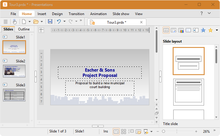

The sidebar is the small pane that is displayed by default on the far right of the document window.

tour_3_sample_sidebar
A document window with mini sorter (on the left) and sidebar (on the right)
The sidebar can be used to display, for example, all available slide layouts. To change the layout of the current slide, all you have to do is click on one of the layouts listed in the sidebar. The change will be then be applied immediately to the slide.
Thus, the sidebar allows you to change the layout of a slide (and many other settings) with a single mouse-click.
Note: Unlike dialog boxes, the sidebar does not have OK and Cancel buttons. Instead, changes are applied immediately. However, you can undo inadvertent changes at any time via the command Undo undo_solo in the Quick access toolbar.
