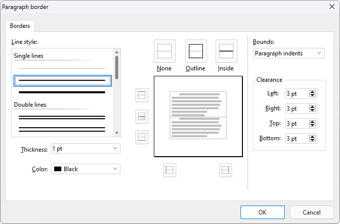

Other options: Via the dialog box of the command group "Paragraph"
For additional options, such as the color or different thickness of lines, there are various options available in the dialog box.
You open the dialog box by clicking on the arrow of the icon borders_icon and selecting Borders in the dropdown menu.
Alternatively: On the ribbon tab Home | group Paragraph, click on the group arrowgroup_arrow and switch to the Borders tab.
borders_dialog
Dialog box for border lines (here: for text paragraphs)
A similar dialog box also appears for table cells. You use both dialog boxes in the same manner.
Essentially, you use this dialog box as follows:
1.First, you specify what type of border line you want to apply (line style, thickness, color).
2.Then specify where this type of border line should be placed. To do so, simply click on the desired lines (or their buttons) in the right half of the dialog box.
Let's take a closer look at the individual steps:
For example, to add border lines to a text paragraph, proceed as follows:
1.Place the text cursor in the desired paragraph (or select several paragraphs).
2.On the ribbon tab Home | group Paragraph, click on the group arrowgroup_arrow for the dialog box and switch to the Borders tab.
3.First, specify what type of border line you want to apply. You have the following options:
Line style (single, double or dashed lines)
Thickness of the line
Color of the line
4.Then specify where you want to apply this type of border line (top, bottom, left, right, etc.).
For this purpose, a preview box surrounded by a set of buttons is available in the right half of the dialog box. Use it as follows:
A.In the preview in the right half of the dialog box, simply click directly on all lines to which a border line is to be applied.
B.Alternatively, you can use the buttons that are displayed to the left and below the preview for this purpose. Each button represents a specific line (see icon on the button).
C.The buttons above the preview are useful shortcuts:
The Outline button applies the currently set border line to all outer borders.
The Inside button does the same for all inner lines (the "gridlines" between the table cells).
The None button removes all lines at once.
5.Add as many lines as you like by simply repeating step 4.
Of course, you can always change the line style, thickness or color (step 3) before applying it (step 4).
6.When everything is as required, confirm with OK.
Detailed information on the individual options in this dialog box can be found below.
Editing or removing existing border lines in the dialog box
You can change the style, thickness or color of existing border lines or also remove them at any time. To do so, open the dialog box again and proceed as follows:
▪Changing: To change the appearance of a line, first select the desired settings (style, thickness, color). Then, in the preview, click on the line (or its button) to which you want to apply these settings.
▪Removing: To remove a border line, click on that line (or its button) twice in the preview. Clicking once applies the border line, while clicking it again removes it.
Tip: The None button displayed above the preview removes all lines at once.
Dialog box options (detailed)
In the dialog box for border lines described above, the following adjustments are possible:
▪Line style
This option determines the type of line to be drawn. You can choose between different variations of single, double and dashed lines.
▪Thickness
This option determines the width of the line.
▪Color
Here, you can change the colors of the line.
In addition to the colors offered here, you can define new colors at any time. For more information, see Colors.
▪Preview box
A preview box is displayed in the right half of the dialog box. This shows what the border lines would look like when applied after you exit the dialog box with OK.
The preview box is also used to apply and remove lines:
If you click on one of the lines in this preview, the corresponding line is enabled – or disabled when you click it again. The settings currently selected in the dialog box (line style, line thickness, color) are used for this purpose.
Alternatively, you can use the buttons to the left and below the preview for this purpose. Each button represents a specific line, which is indicated by the icon on the button.
The buttons shown above the preview are shortcuts: None removes all lines at once, Outline adds lines to all outer borders, Inside does the same for all inner lines (for example, for table cells).
