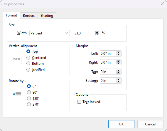

You open the dialog box with the ribbon command Table | Properties dropdown_arrow | Cell properties.
tables_cell_properties_dialog
In the dialog box, the Format tab offers the following options:
Size
Here, you can change the Width of the selected cells by choosing from among the following options:
▪Fixed
If you select this option, you can specify the width exactly. Enter the desired value to the right of it.
▪Percent
If you select this option, you can enter the desired width as a percentage of the overall table width.
For example, each cell in a table of three columns has a default width of 33.3%. If, for example, you want the first column to be twice as wide as the other two columns, enter "50" for all cells in the first column and "25" for the cells in the second and third columns.
▪Auto
If you select this option, TextMaker automatically determines an appropriate width. In this case, the cell widths will be evenly divided into the available space.
Any of these three options can be applied in any combination within the same table. For example, you can create a table where the cells in the first column have a fixed width, but the other columns are set to "Auto". If you then increase the width of the first column, the other columns will automatically become narrower accordingly.
Tip: Cell widths can also be changed with the mouse. To do so, drag the right border of a cell left or right with your mouse. If you have not selected anything, the width of the entire column changes. If you have selected specific cells, however, only their width changes.
Vertical alignment
This setting determines how the cell contents should be aligned within the cell:
Option
Explanation
Top
The cell content will be aligned to the top edge of the cell. (This is the default setting.)
Centered
The cell content will be centered between the top and bottom edges of the cell.
Bottom
The cell content will be aligned to the bottom edge of the cell.
Justified
The lines of text within the cell are vertically justified and are thus evenly distributed so that the text starts exactly at the top edge of the cell and ends exactly at the bottom edge.
Rotate by...
Here, you can specify the angle of rotation for the cell content.
Margins
Here, you can change the inner margins of the selected cells.
Options
If you enable the option Text locked, you will not be able to change the contents of the selected table cells when the document is edited in form mode.
However, this option is disabled by default; thus the cells can also be edited in form mode.
For more information, see Protecting contents of form objects.
