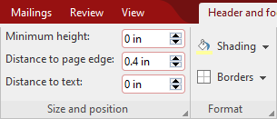

First, click with the mouse in the header or footer frame – depending on whether you want to edit the headers or footers – and customize the following properties according to your needs:
▪Command group Size and position
You can enter the desired values in the respective input fields or increase/decrease the values with the small arrow buttons. The following settings are possible:
Minimum height: Here, you can set the minimum height of the header or footer frame. The other option Fixed values can be found in the dialog box, see below.
Distance to page edge: Distance between the frame and the edge of the page.
Distance to text: Distance between the frame and the body text.
▪Command group Format: Shading cell_shading_icon
If you click on the small arrow on the Shading icon, you will see a dropdown menu with standard colors and color variations that you can apply.
The last selected color is displayed as a horizontal bar in the icon. This "memory function" also applies to other shading settings, such as patterns or shades (which can only be found in the dialog box). You open the dialog box by clicking on the icon's black arrow and selecting More in the dropdown menu. For more information, see below.
Removing shading: Click on Transparent in the dropdown menu to remove existing shading.
