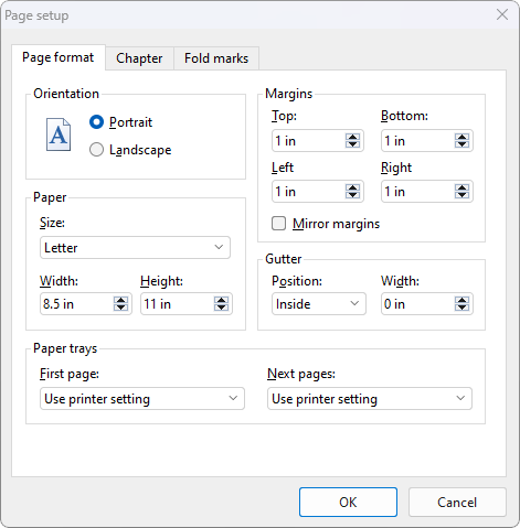

Applying via the dialog box of the command group "Page setup"
On the ribbon tab Layout | group Page setup, click on the group arrowgroup_arrow in the lower right corner to open the dialog box and switch to the Page format tab.
page_setup_dialog
The following options are available in this dialog box:
▪Orientation
Here, you can specify the Orientation of the document on the printed page: Portrait or Landscape.
▪Paper
You can specify the paper size for the printed pages here. The dropdown list Size contains all paper sizes that are supported by the current printer. If you want to specify a size that is not listed, you can do so by manually specifying values in the fields Width and Height.
▪Margins
You can set the page margins here
▪Mirror margins
Ideal for book printing The page margins that you would otherwise set as left and right margins change to inner and outer margins when this option is enabled. The set distances to the page margins then appear with an equal width to the inner margin and an equal width to the outer margin in a multi-page document.
Tip: On the ribbon tab View, enable the option Book layout book_layout_icon so that you can view the result better. For more information, see also Customizing the document display.
▪Gutter
A gutter can be added in addition to the page margins. The gutter is an additional margin that, for example, is required for the fold when such a document is printed and then bound or stapled together.
You can specify the position and size of the gutter.
Note: The option "Mirror margins" (see above) only permits the inside position.
▪Paper trays
Only available in Windows version: If your printer has multiple paper trays, you can set the tray which the printer should use. If you have selected the default setting Use printer setting, TextMaker does not affect the paper feed. If, for example, you want the first page of your document to be printed on paper from tray 1 and the remaining pages on page from tray 2, you should change this setting accordingly.
There are also two more tabs in the dialog box "Page setup":
▪ Chapter tab
This tab contains settings for the chapter format, which is discussed in Dividing a document into chapters).
▪Fold marks tab
On this tab, you can insert tri-fold marks and bi-fold marks at the beginning of each chapter. For more information, see Fold marks.
