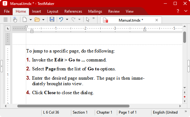

The Bulleted lists section describes how to use the command Bullets bullets_icon on the ribbon tab Home | group Paragraph to add a "bullet" to certain paragraphs.
Right next to it is the command for applying Numbering numbering_icon to paragraphs. TextMaker automatically indents the paragraphs at the left to make room for the numbers and then assigns a sequential number to the paragraphs.
numbering_sample
Paragraphs with numbering
You can use as many numbered bullets as you want within a document. The numbering is automatically reset to one at the start of each new list.

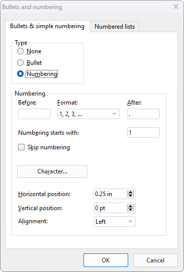

Other options: Via the dialog box "Bullets and numbering"
To open the numbering dialog box, click on the arrow next to the icon numbering_icon on the ribbon tab Home | group Paragraph. Select Format numbering from the dropdown menu.
Tip: If numbering already exists, you can access the dialog box even faster by clicking on the numbering directly in the text.
numbering_dialog
In the open dialog box, you can make the following settings for numbering on the Bullets and simple numbering tab:
▪Type
Here, you can specify either Numbering or a Bullet for the selected paragraph(s). Select the Numbering option for numbering. (For information on the option Bullet, see Bulleted lists.)
Note: You can always convert a numbered list into a bulleted list simply by changing the "Type" to Bullet. You can also do it the other way round, of course.
If you set the type to None, existing bullets or numbers are removed.
▪Before and After
If necessary, you can specify text to be added before and/or after the number that TextMaker will assign to the paragraph. If, for example, you want the numbers to be surrounded by dashes (-1-, -2-, -3- etc.), select the Format "1, 2, 3, ..." and enter "-" in the Before and After fields.
▪Format
Here, you specify the format of the numbering. In addition to the usual Arabic numbers (1, 2, 3, etc.), you can also select letters (A, B, C, etc.) or Roman numerals (I, II, III, etc.).
▪Numbering starts with ...
TextMaker starts every numbered list at "1" by default. If you want to use a different start value, enter "5" here, for example, and the numbering will start at "5".
Tip: Furthermore, you can also do the following (of particular interest for legal texts): If, for example, you have set the numbering a, b, c, etc., for the above option Format, and have entered the start value "aa", you create numbering like aa, bb, cc, etc. Alternatively, if you enter the start value "aaa", you create numbering like aaa, bbb, ccc, etc.).
▪Skip numbering
Within a numbered list, you often require a paragraph for which the numbering is to be temporarily suspended, but then resumed for the following paragraph. To do so, position the text cursor in the numbered paragraph that you want to exclude from the numbering and select the option Skip numbering.
The selected paragraph's number is then removed, and only its indentation is retained. The numbering resumes for the following paragraph.
▪Character button
You can click on this button to change the character formatting (font and font size, text styles, etc.) for the numbers.
▪Horizontal position
This option allows you to specify how far the text should be indented to the right to make room for the numbers.
▪Vertical position
This option allows you to specify the vertical position of the numbers. If the value is negative, the number is positioned lower. It is positioned higher if the value is positive.
▪Alignment
This option determines how the numbers that are below each other are aligned: left-aligned, centered, or right-aligned (especially relevant when transitioning to two-digit or three-digit numbers).
