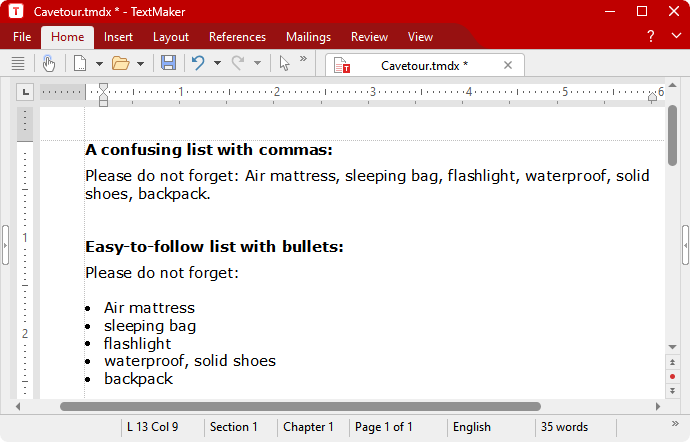

Lists in which each item is presented in its own paragraph preceded by a marker are usually much easier to read than lists that are separated by commas.
Such markers (for example, little boxes, circles, arrows. etc.) are called bullets.
Creating bulleted lists is an easy task for TextMaker users: TextMaker can add bullets to paragraphs and automatically indent them at the touch of a button.
bullets_sample

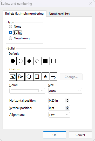

Other options: Via the dialog box "Bullets and numbering"
To open the "Bullets" dialog box, click on the arrow next to the icon bullets_icon on the ribbon tab Home | group Paragraph. In the dropdown menu, select Format bullets.
Tip: If a bullet already exists, you can access the dialog box even faster by clicking directly on the bullet in the text.
bullets_dialog
In the open dialog box, you can make the following settings for the bullets on the Bullets & simple numbering tab:
▪Type
Here, you can specify whether the paragraphs should be given a Bullet or Numbering. Thus select the option Bullet here for bullets. (For more information about the option Numbering, see Simple numbering.)
Note: You can always convert a bulleted list into a numbered list by simply changing the "Type" to Numbering. You can also do it the other way round, of course.
When you set the type to None, existing bullets or numbers are removed.
▪Default and Custom
Here, you can select the bullet to be used. The Default row contains predefined bullets from which you can choose, and you can create your own bullets in the Custom row (see below).
▪Color (only for default bullets)
You can select a different color for the bullet in the dropdown list Color. In addition to the colors offered here, you can define new colors at any time. For more information, see Colors.
Tip: If you set the color to "Auto", TextMaker automatically uses the font color of the paragraph to the right of the bullet.
▪Size (only for default bullets)
Here, you can change the size (in points) of the bullet.
Tip: If you select the option "Auto" here, TextMaker automatically uses the font size of the paragraph to the right of the bullet.
▪Character button (only for custom bullets)
For custom bullets, the Character button appears instead of the two options above. Click on this button if you want to change the character format (font size, color, text styles, etc.) of the bullet.
Tip: If you do not change these settings, the bullet automatically uses the character format of the paragraph to the right of the bullet (except for the font).
▪Horizontal position
This option allows you to specify how far the text should be indented to the right to make room for the bullets.
▪Vertical position
This option allows you to specify the vertical position of the bullet on the line. If the value is negative, the bullet is positioned lower. It is positioned higher if the value is positive.
▪Alignment
This option is mainly relevant for flush alignment of numbers and numbered lists. Left reduces the distance to the text, and right increases it.
▪Numbered lists tab
This tab gives access to an additional option for creating lists with bullets or numbers: numbered lists. Here, numbered lists can be saved and re-used whenever you need them. In addition, hierarchical numbering (1., 1.1., 1.1.1., etc.) is also possible via numbered lists.
For more information on numbered lists, see Numbered lists.
