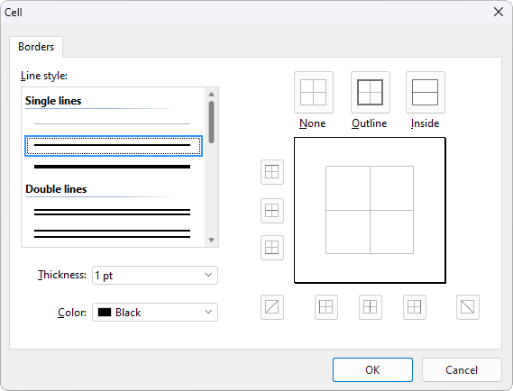

Other options: Via the dialog box
For additional options, such as the color or different thickness of lines, there are various options available in the dialog box.
You open the dialog box by clicking on the arrow of the icon borders_icon and selecting Borders in the dropdown menu.
Alternatively: On the ribbon tab Home | group Alignment, click on the group arrowgroup_arrow and switch to the Borders tab.
borders_dialog
Essentially, you use this dialog box as follows:
1.First, you specify what type of border line you want to apply (line style, thickness, color).
2.Then specify where this type of border line should be placed. To do so, simply click on the desired lines (or their buttons) in the right half of the dialog box.
Let's take a closer look at the individual steps:
To add border lines to cells, for example, proceed as follows:
1.Select the desired cells.
2.On the ribbon tab Home | group Alignment, click on the group arrowgroup_arrow for the dialog box and switch to the Borders tab.
3.First, specify what type of border line you want to apply. You have the following options:
Line style (single, double or dashed lines)
Thickness of the line
Color of the line
Note: In addition to the colors offered here, you can define new colors at any time. For more information, see Colors.
4.Then specify where you want to apply this type of border line (top, bottom, left, right, etc.).
For this purpose, a preview box surrounded by a set of buttons is available in the right half of the dialog box. Use it as follows:
A.In the preview in the right half of the dialog box, simply click directly on all lines to which a border line is to be applied.
B.Alternatively, you can use the buttons that are displayed to the left and below the preview for this purpose. Each button represents a specific line (see icon on the button).
C.The buttons above the preview are useful shortcuts:
The Outline button applies the currently set border line to all outer borders.
The Inside button does the same for all inner lines (the "gridlines" between the cells).
The None button removes all lines at once.
5.If required, you can add as many lines as you like by simply repeating step 4.
Of course, you can always change the line style, thickness or color (step 3) before applying it (step 4).
6.When everything is as required, confirm with OK.
The table cells are now provided with the relevant lines.
Editing or removing existing border lines in the dialog box
You can change the style, thickness or color of existing border lines or also remove them at any time. To do so, open the dialog box again and proceed as follows:
▪Changing: To change the appearance of a line, first select the desired settings (style, thickness, color). Then, in the preview, click on the line (or its button) to which you want to apply these settings.
▪Removing: To remove a border line, click on that line (or its button) twice in the preview. Clicking once applies the border line, while clicking it again removes it.
Tip: The None button displayed above the preview removes all lines at once.
