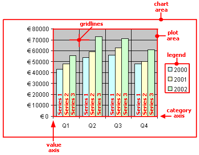

Charts consist of several components. In addition to the data series themselves, for example, there are axes, a legend, etc. These individual components of a chart are called the chart elements.
The following figure shows the most important chart elements:
chart_elements_sample
Series 1, Series 2, etc. represent the chart's data series.
Three-dimensional chart types contain some additional chart elements (floor, walls, etc.), which will also be described on the following pages.
Each of these chart elements can be selected at the click of a mouse and then edited.
