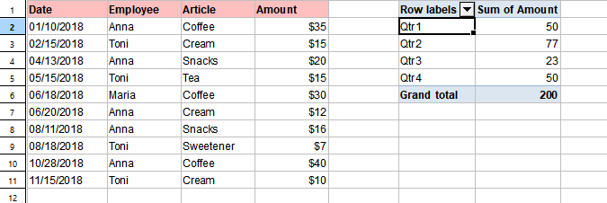

An example:
You have created a pivot table from the familiar sample data (see Creating a new pivot table).
Then, proceed as follows:
1.In the pivot table sidebar, drag the Date field to the Row labels area and the Amount field to the Values area.
2.In the pivot table report, select a cell with a date value.
Note: Only one cell may be selected at a time.
3.Click on the Group... button in the pivot table sidebar.
4.In the dialog box that now appears, select the entry Quarters from the list, for example.
5.In the dialog box, confirm with Group.
The pivot table report then shows the following result: The amounts are summed quarterly.
