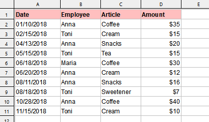

Here, you can see sample data records in PlanMaker from which a pivot table is to be created. The company employees had various expenses for their break room supplies throughout the year. Some employees and some articles appear several times in the relevant columns.
pivot_source_sample_a
Source data for the pivot table
