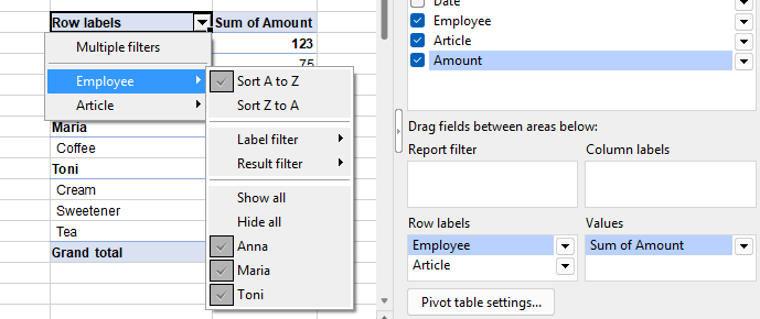

If there are several fields in the row/column labels area (as in the figure above), you can sort each field separately. If you move the mouse in the dropdown menu
to the desired field, the program will open a submenu with the sorting options of this field.

In the pivot table report, open the dropdown menu
to the right of the header Row labels/Column labels. If there is only one field in the Row labels/Column labels area, the choice of filter will be displayed directly for the selected field.
If there are multiple fields in the Row/Column labels area, you can apply separate filters to each field in the pivot table report. If you move the mouse to the desired field in the dropdown menu
of the header, the program will open a submenu with the filter selection of the field.
